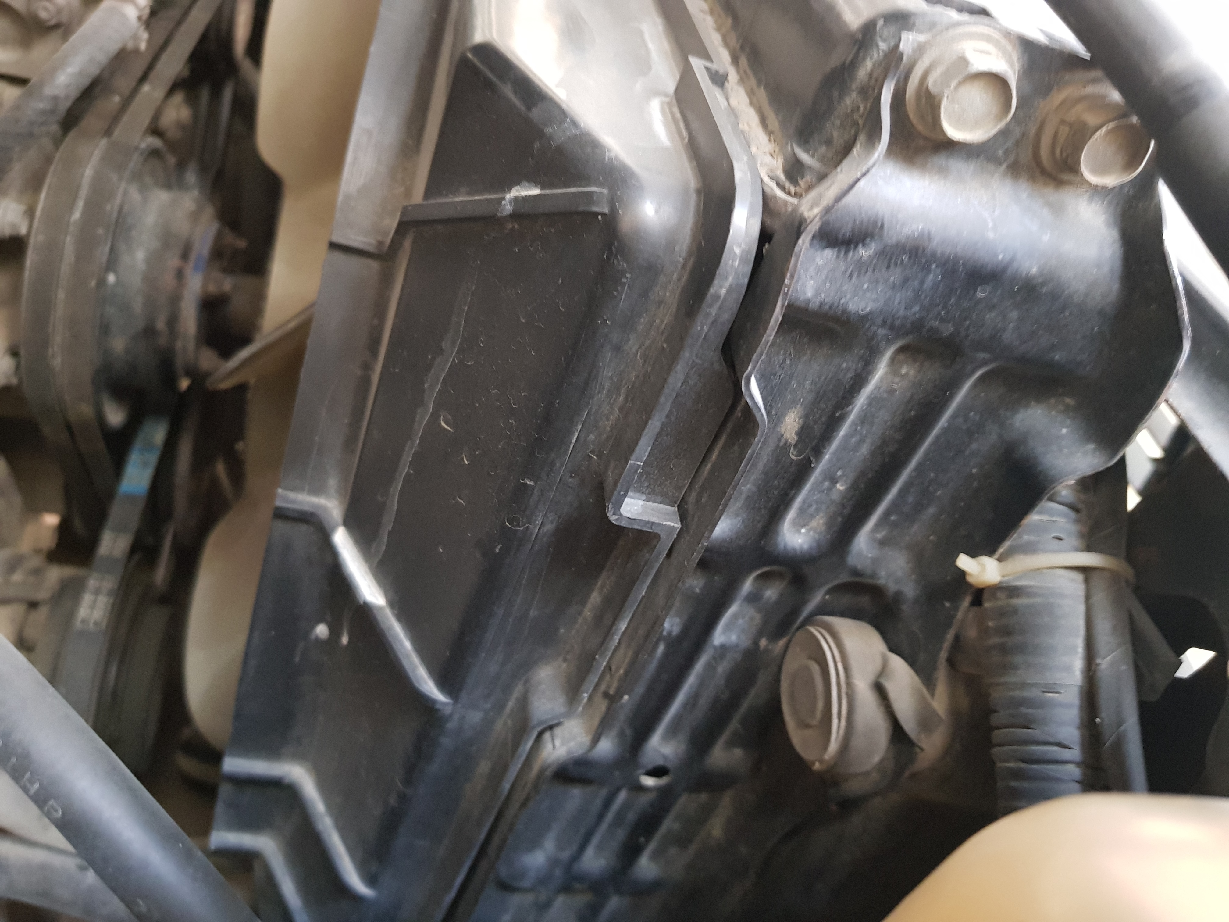

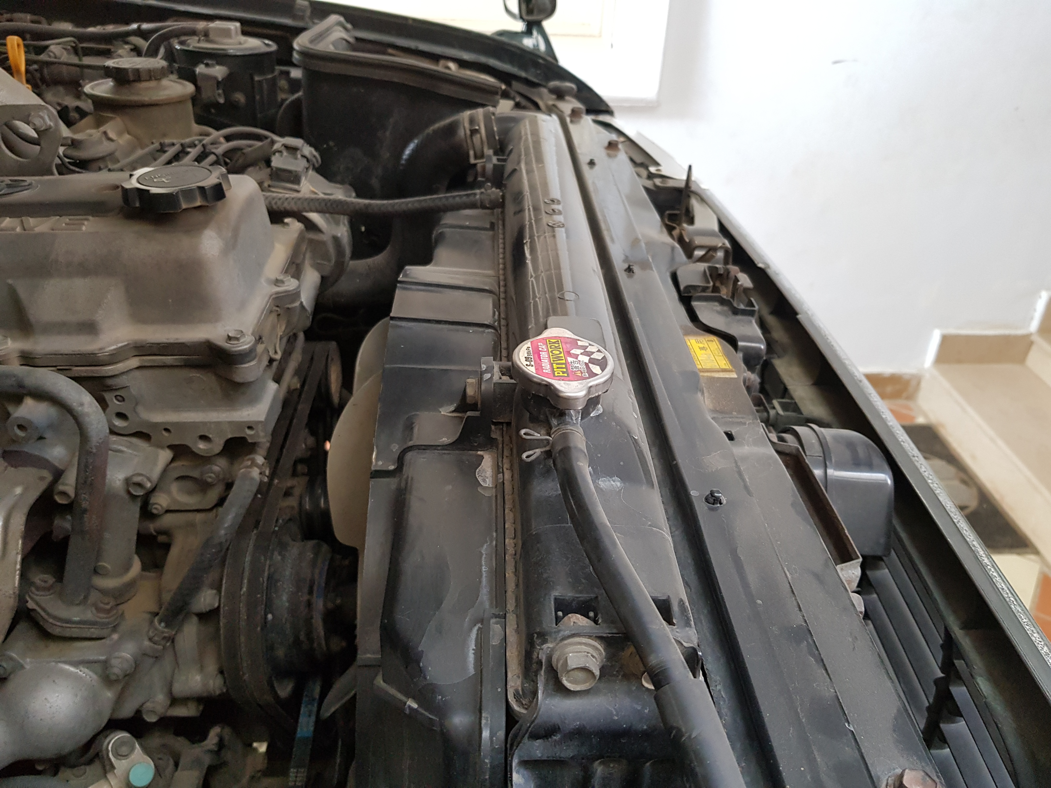

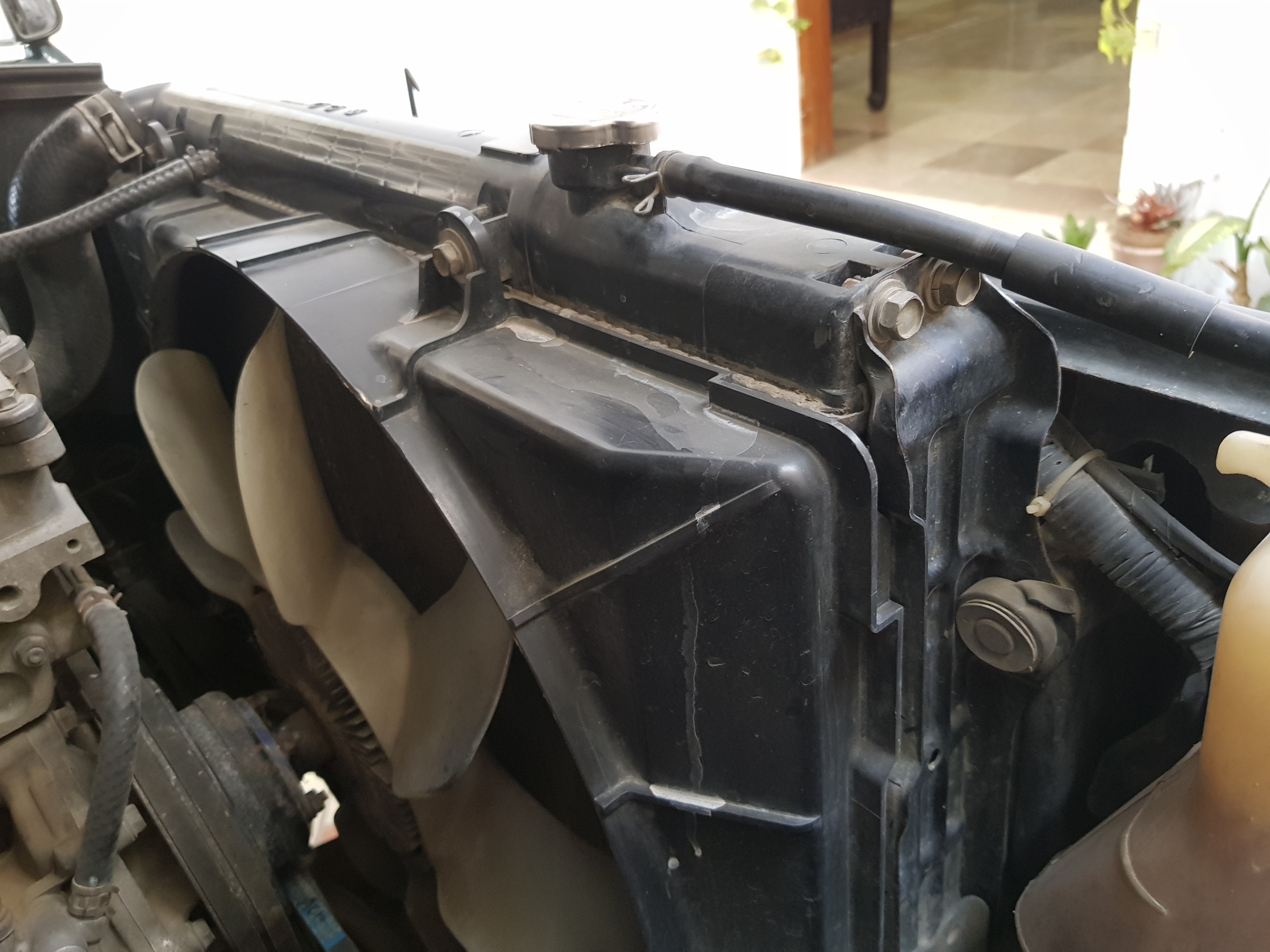

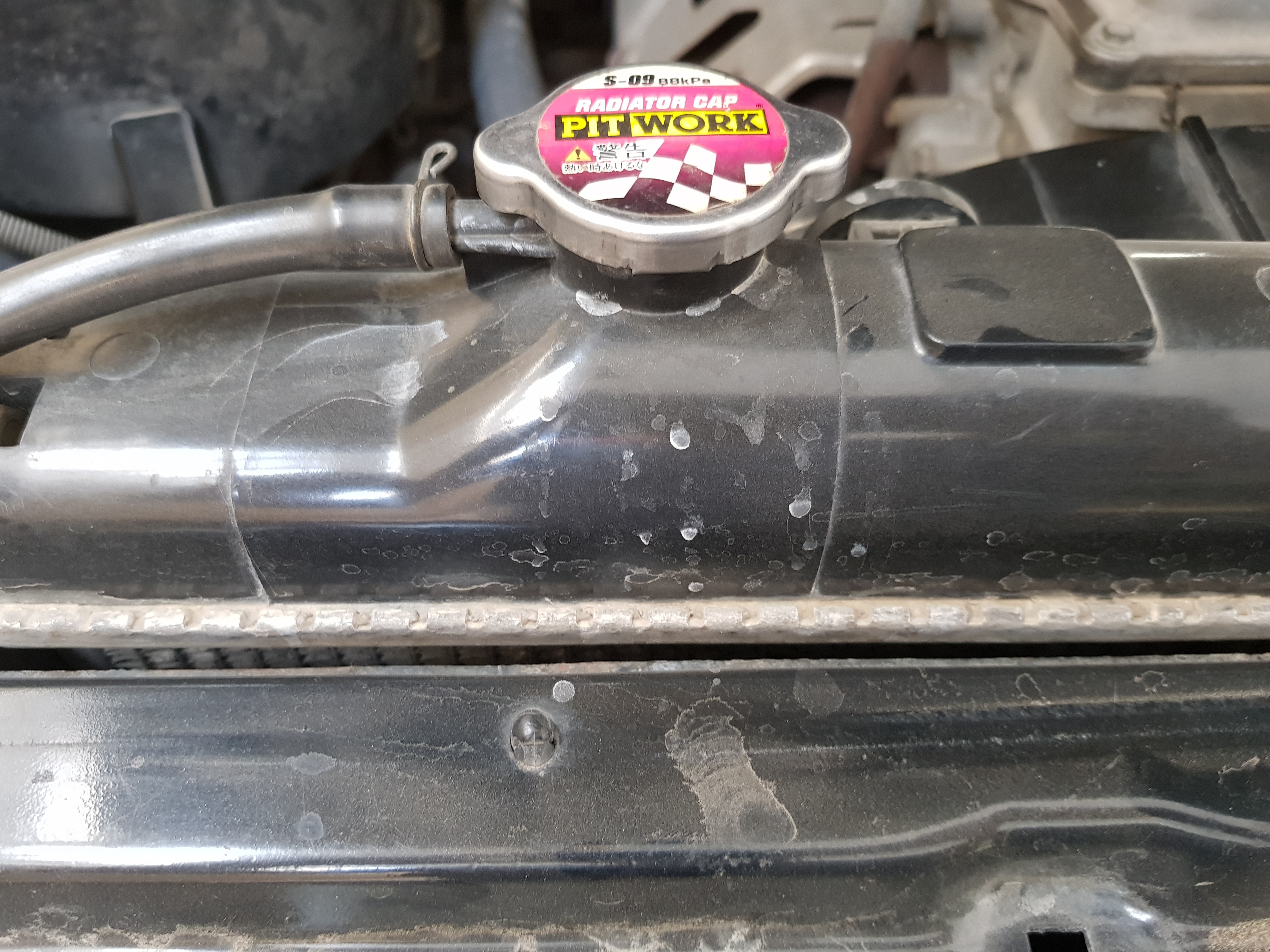

This picture you show has a bit rust in the radiator, this rust deposit when across the whole engine can reduce cooling capacity by 30 to 40%. Make sure the system is perfecly neat and clean when installing parts - specially cooling system. Real offroad 80 series owners who really depend on them run HD radiators, ELC type coolants and coolant zero charge coolant filters too.
