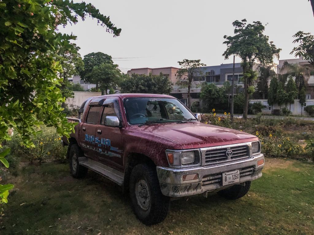

After catching up with some good sleep for like 12-14 hrs, finally i got outside and gave the hilux a detailed look, drove it around my colony for 2-3 KM's and to begin with I identified following things need to be addressed.
First things first, change all fluids for your baseline reading:
1. Change engine oil
2. Change Dif Oils (front and back)
3. Change the gear oil (its a manual transmission machine)
4. Change radiator coolant (it was running on rusted and oxidized water)
5. Change Oil and Diesel Filter.
Phase II: Identification of things which were apparent
1. Make the gauges work (none worked as we speak)
2. Installation of Air Conditioner (it had not even a blower installed to it)
3. Get the exhaust fixed (it was too loud due to a faulty header washer)
4. Run a compression check to see if we need to address a weak engine
5. Check for leakages (oil and coolant), fix as necessary maybe.
