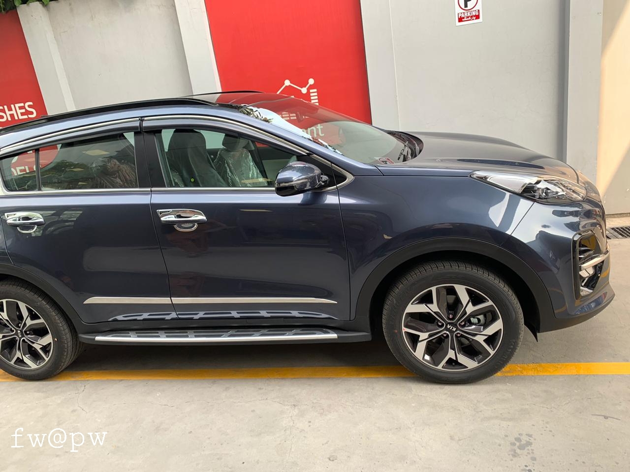

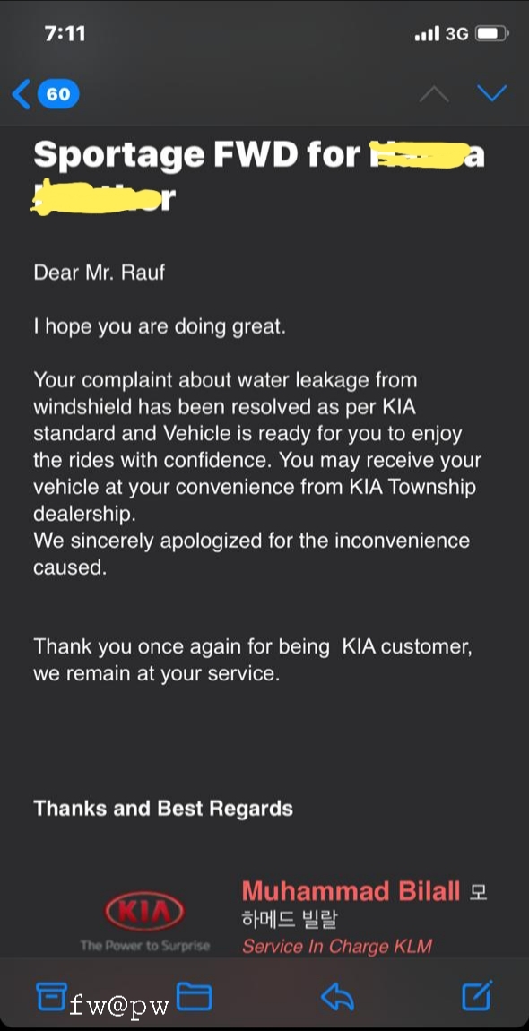

The vehicle as pictured here [ one of the vehicle from the video clips ] was brought to a KIA dealership at Township in Lahore for the leakage problem and it was found that the leakage was actually NOT from the panoramic roof assembly BUT the windshield. The sealant used to hold the windshield in place was defective and the water was going inside the cabin with the swipe of the wiper blade. The windshield was removed from the vehicle along with the sealant , a new bead of sealant was applied and the windshield was installed back on to the vehicle.

I appreciate KIA dealer for stepping up and quickly fixing the issue BUT it is also important that KIA track down all those Sportage unit which might have the expired sealant installed from factory regardless of even no issue reported by the owners of those vehicles at this time. It is better to fix these now with new sealant rather waiting for leakage to happen which can further damage the reputation of the brand.
