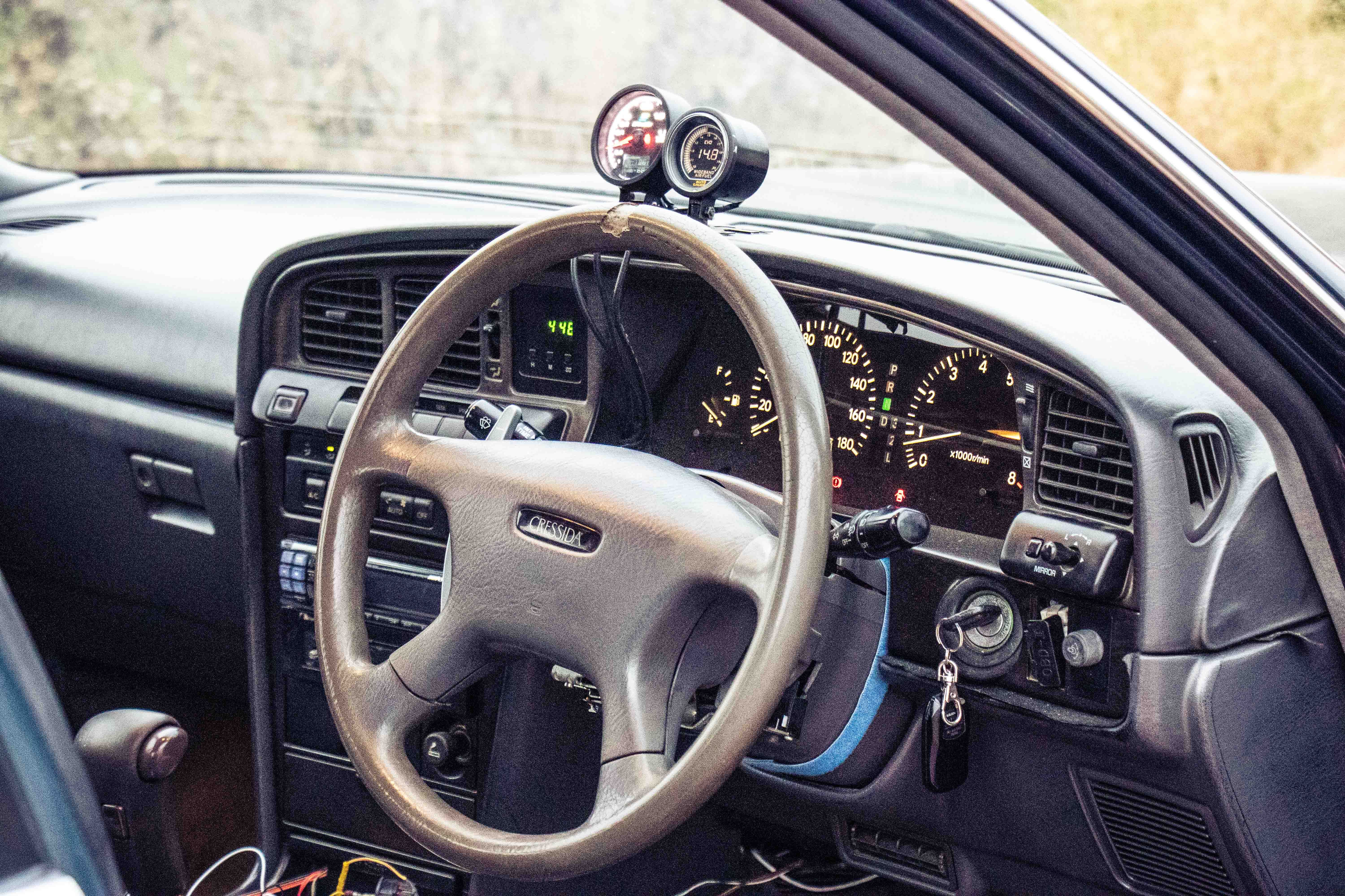

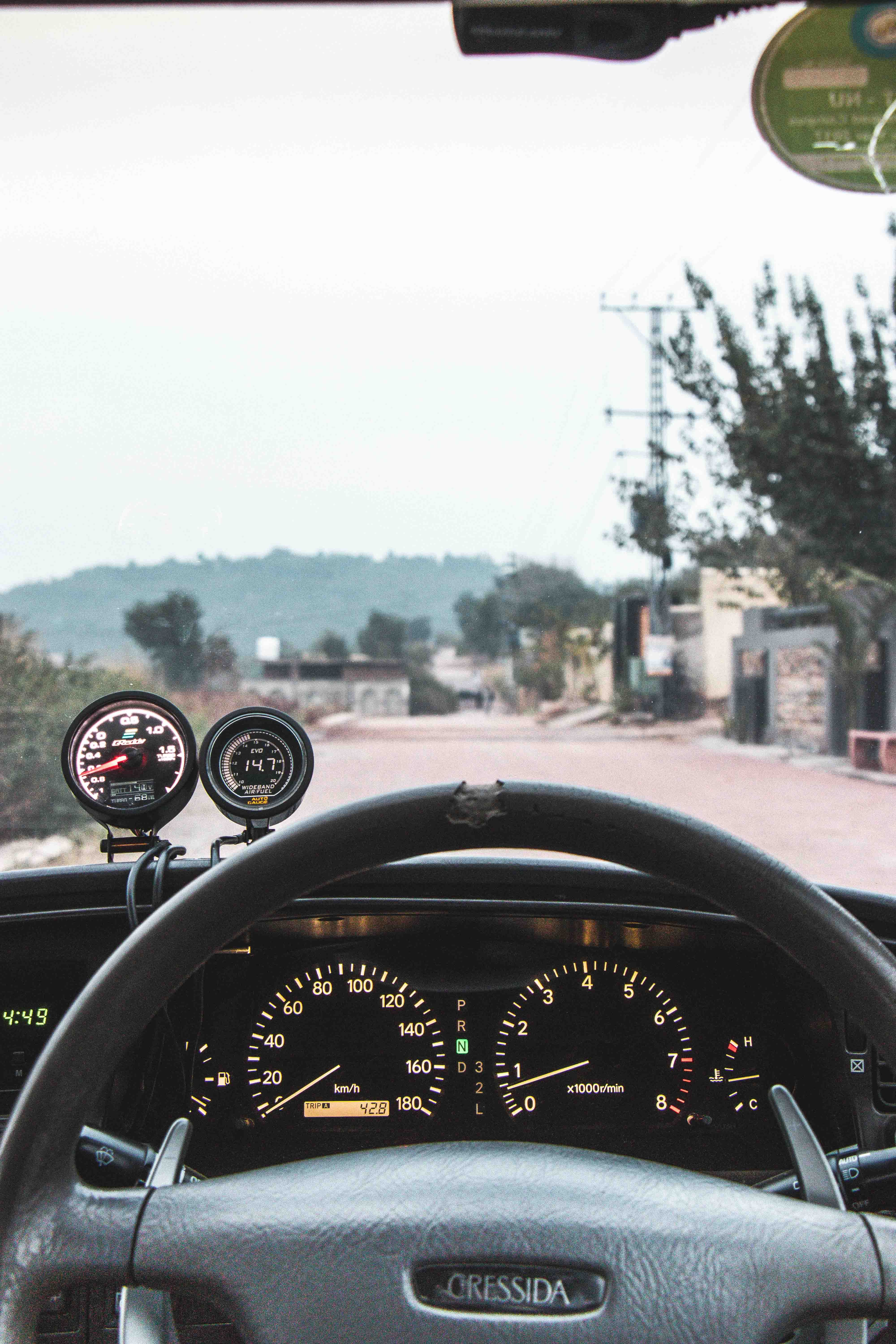

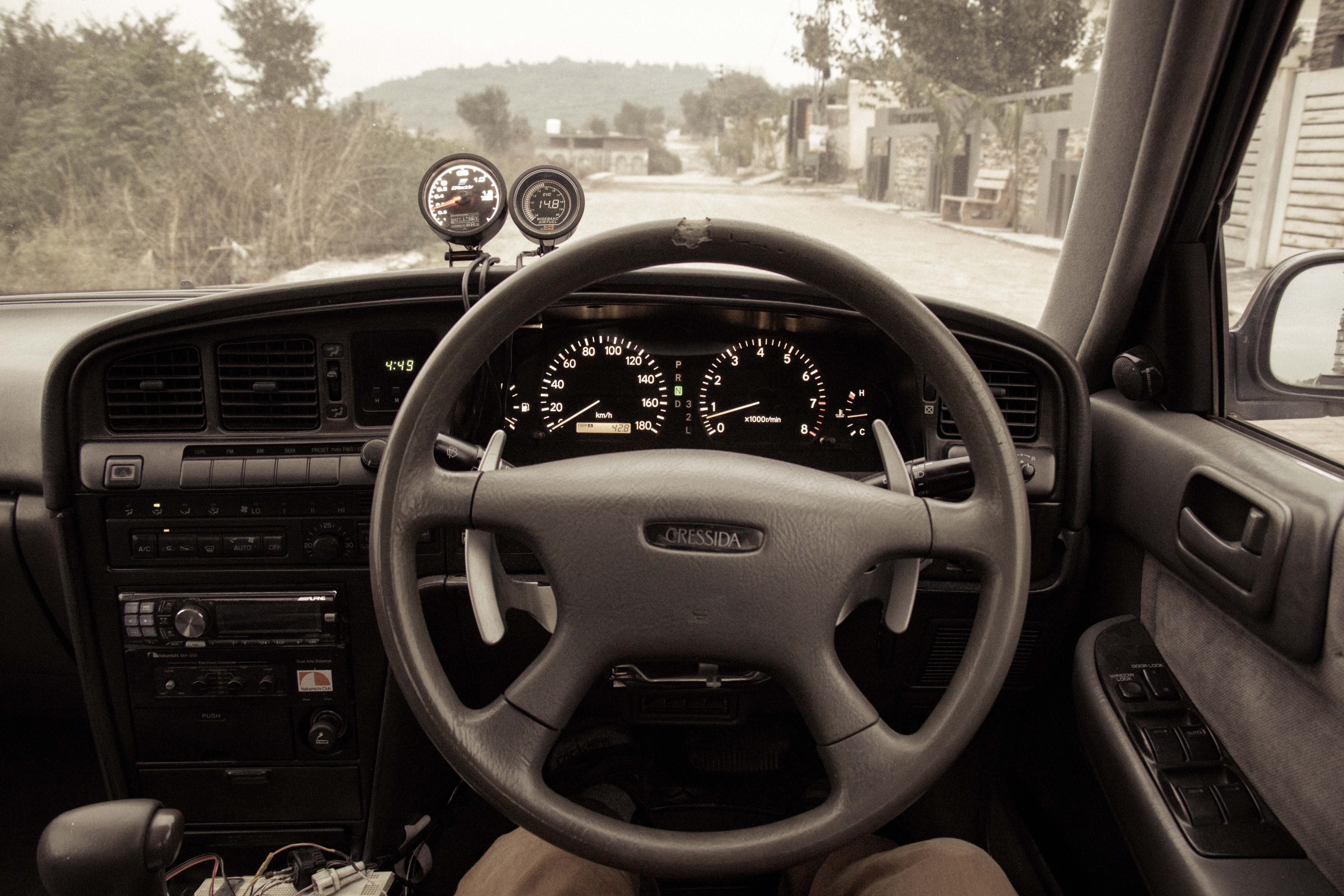

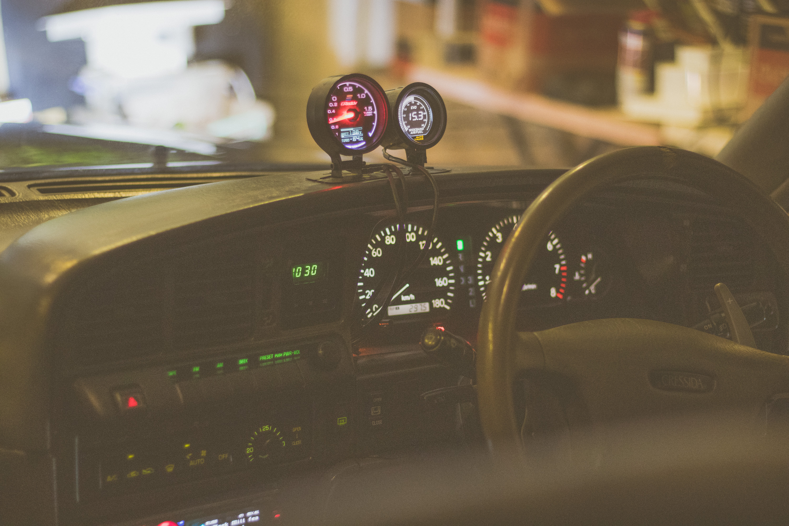

Installed the gear surround switches

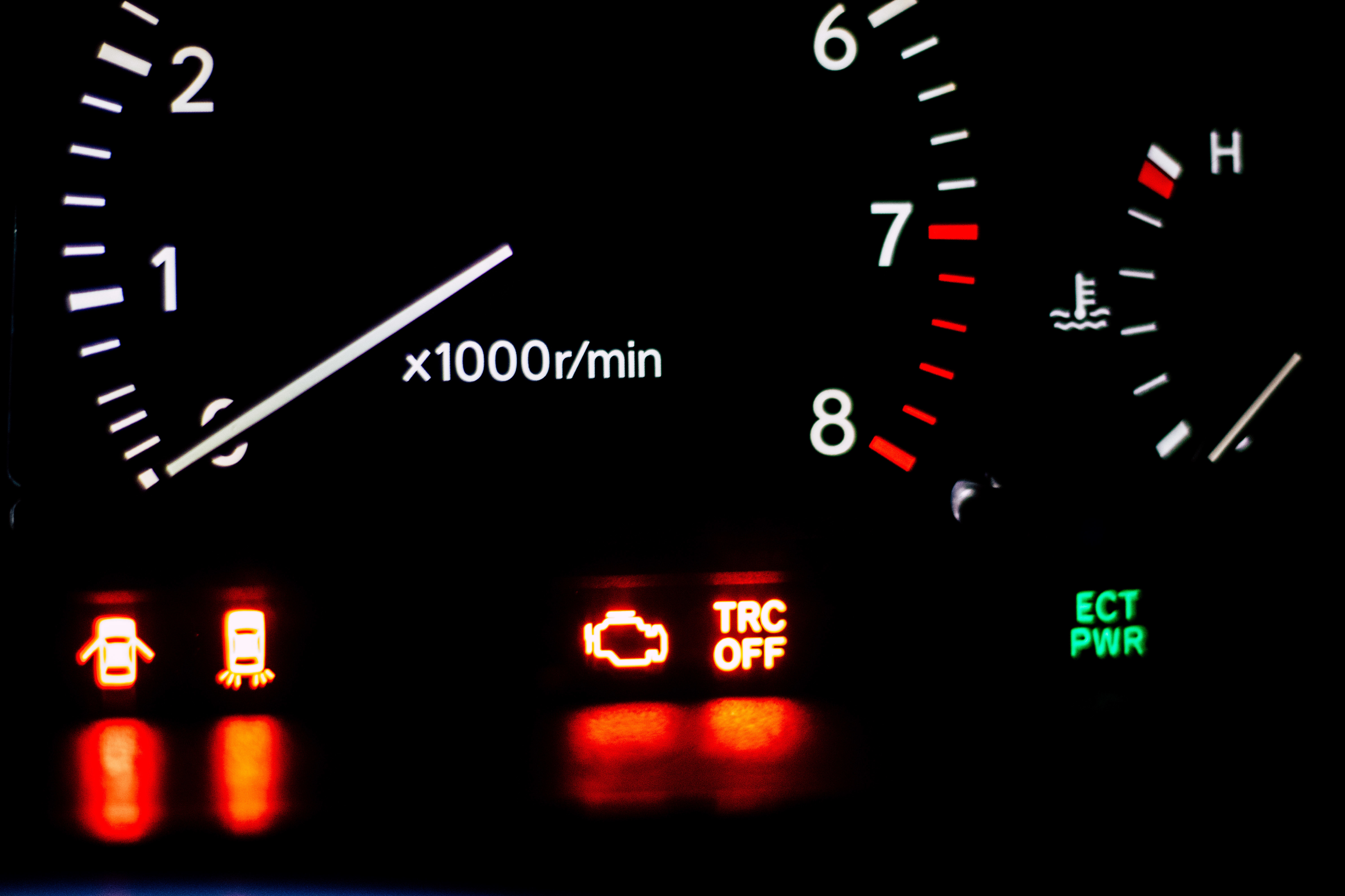

The PWR button when pressed puts the ECU into 'Power Mode' and also switches to a power map on the DET3.
The 'TRC OFF' switch is mapped to the DET3's launch control, so when ever this is pressed, launch control engages.
'MANU' has been left for the valved exhaust, whenever I get to acquire and install that.
The 'PWR' button is mapped to the 'ECT PWR' light on the cluster and the TRC OFF button to the 'TRC OFF' light.

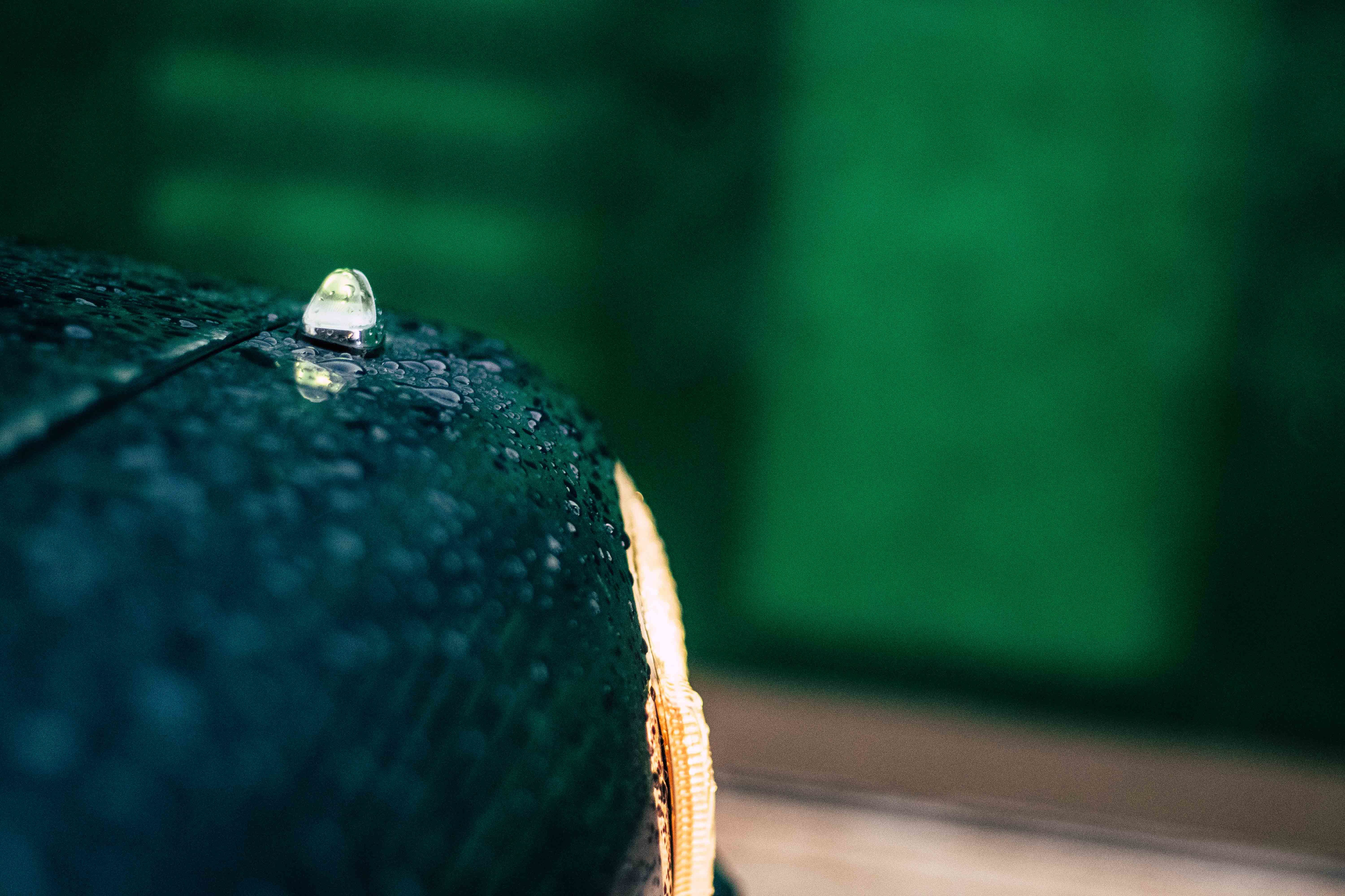

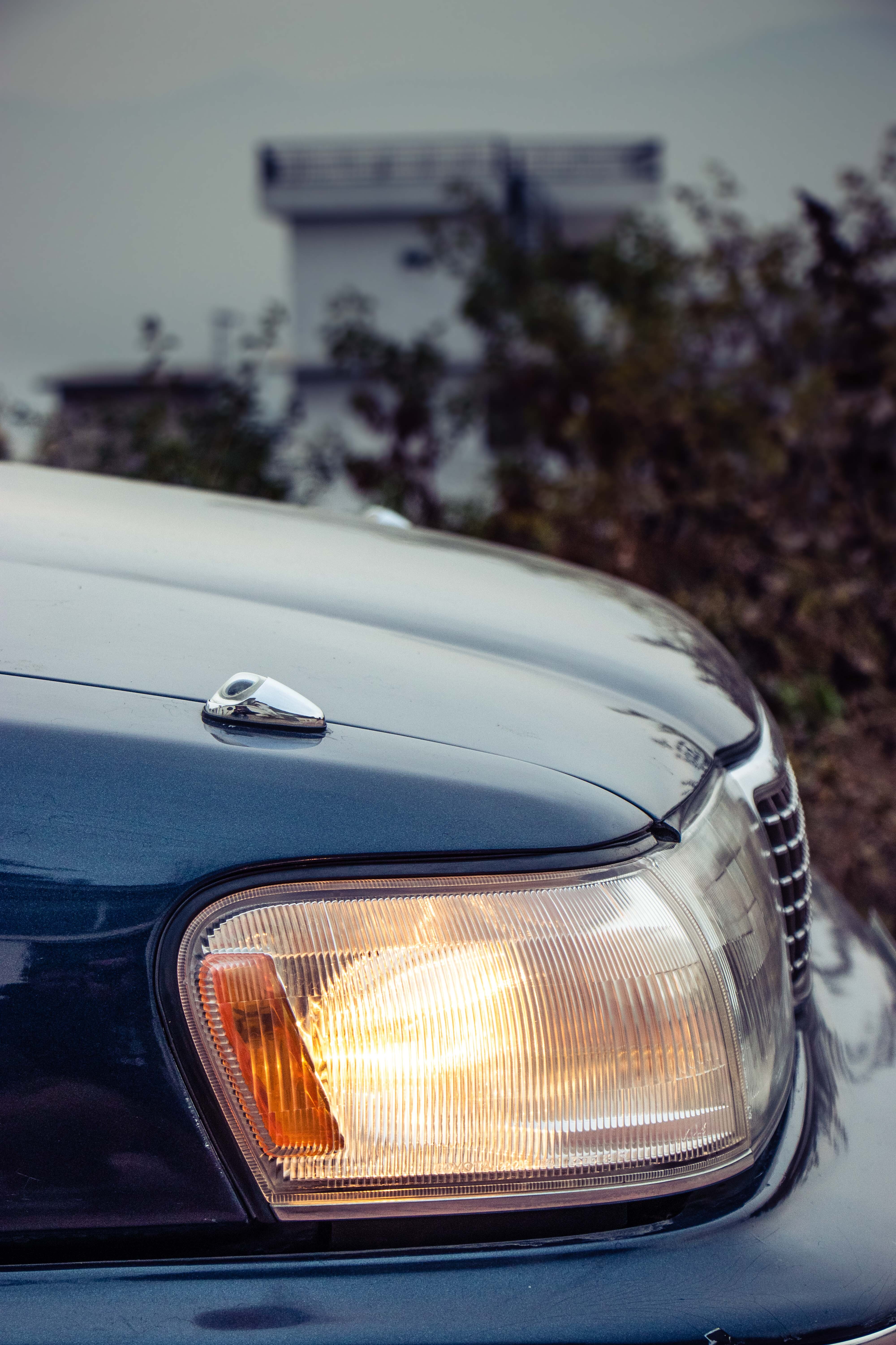

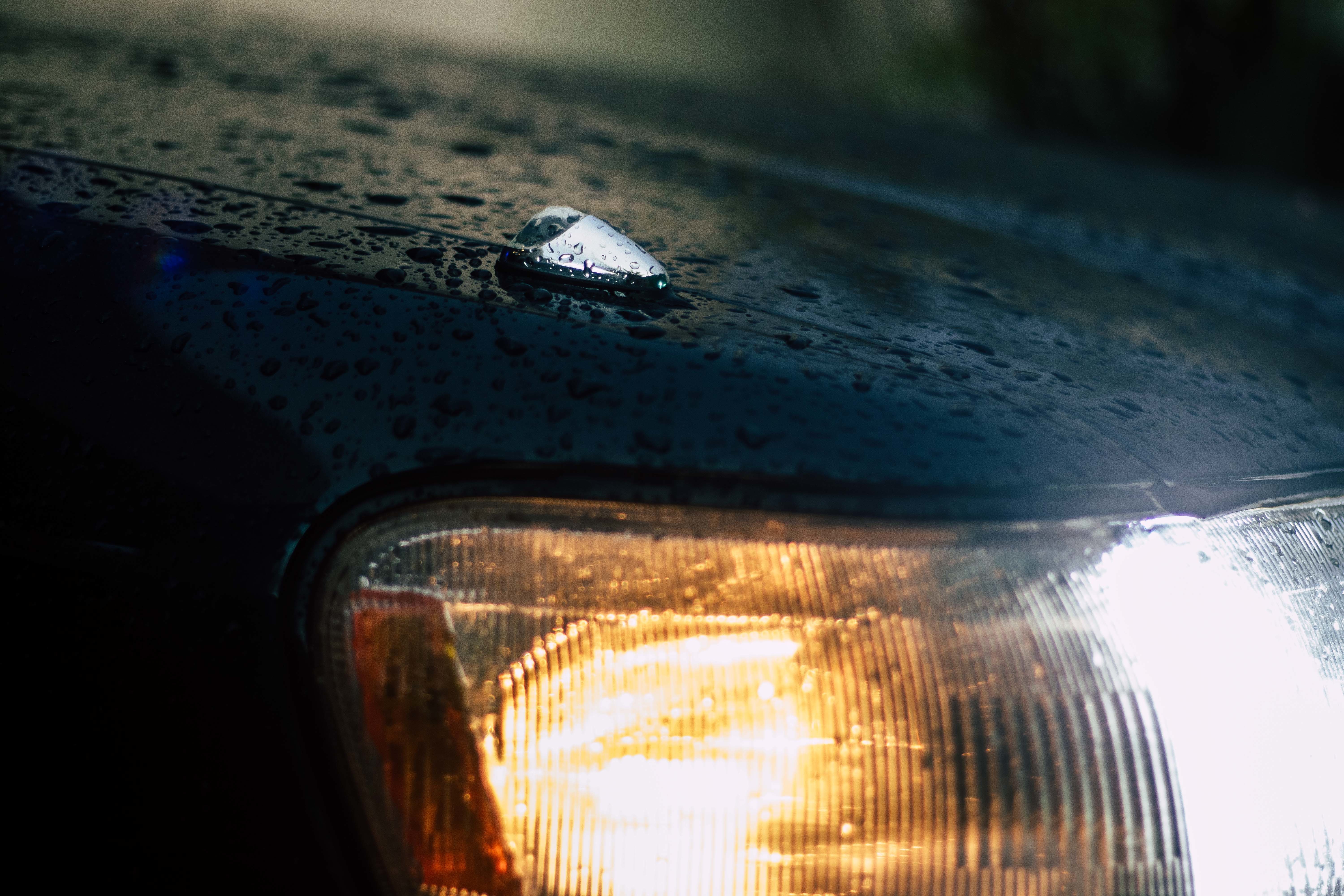

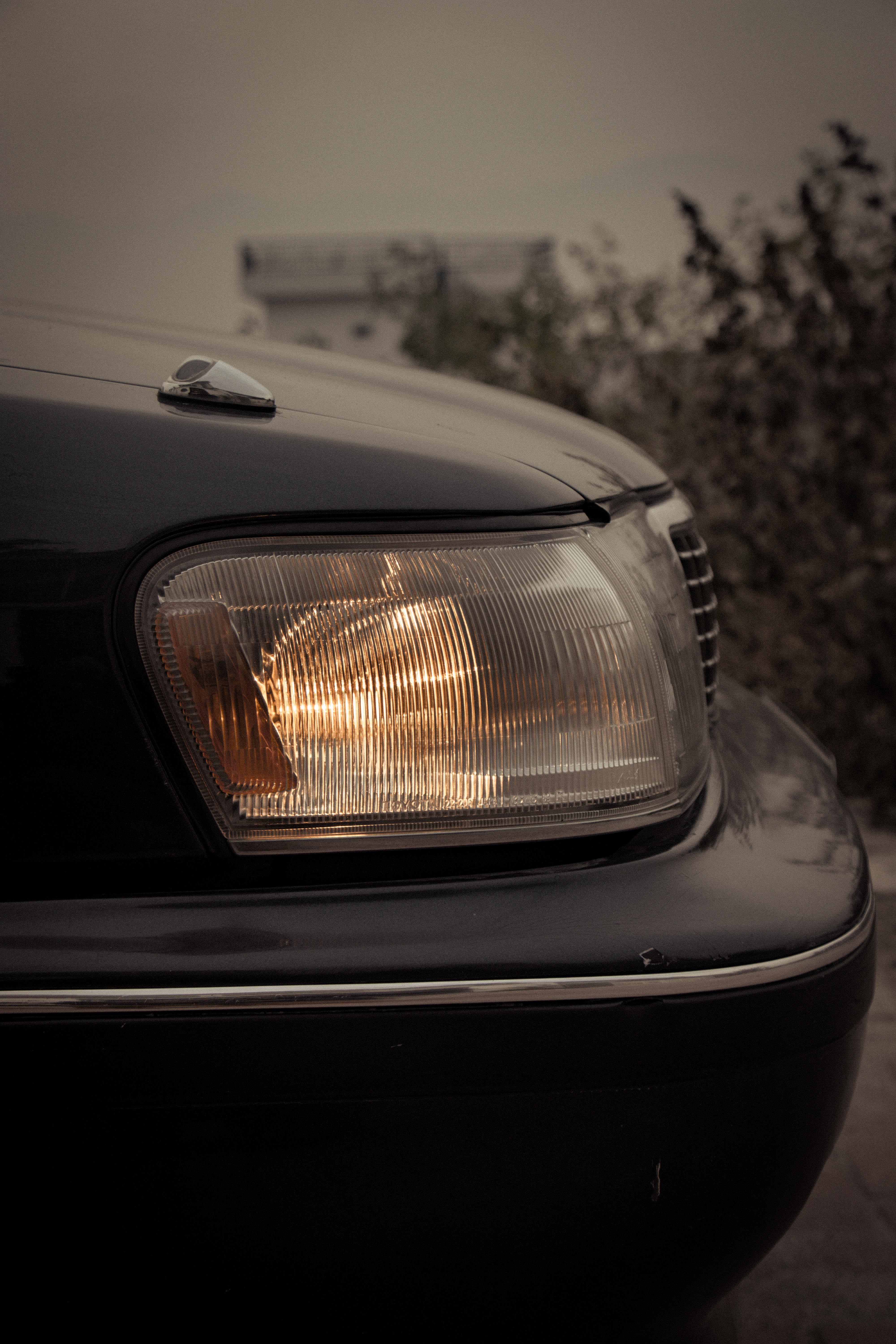

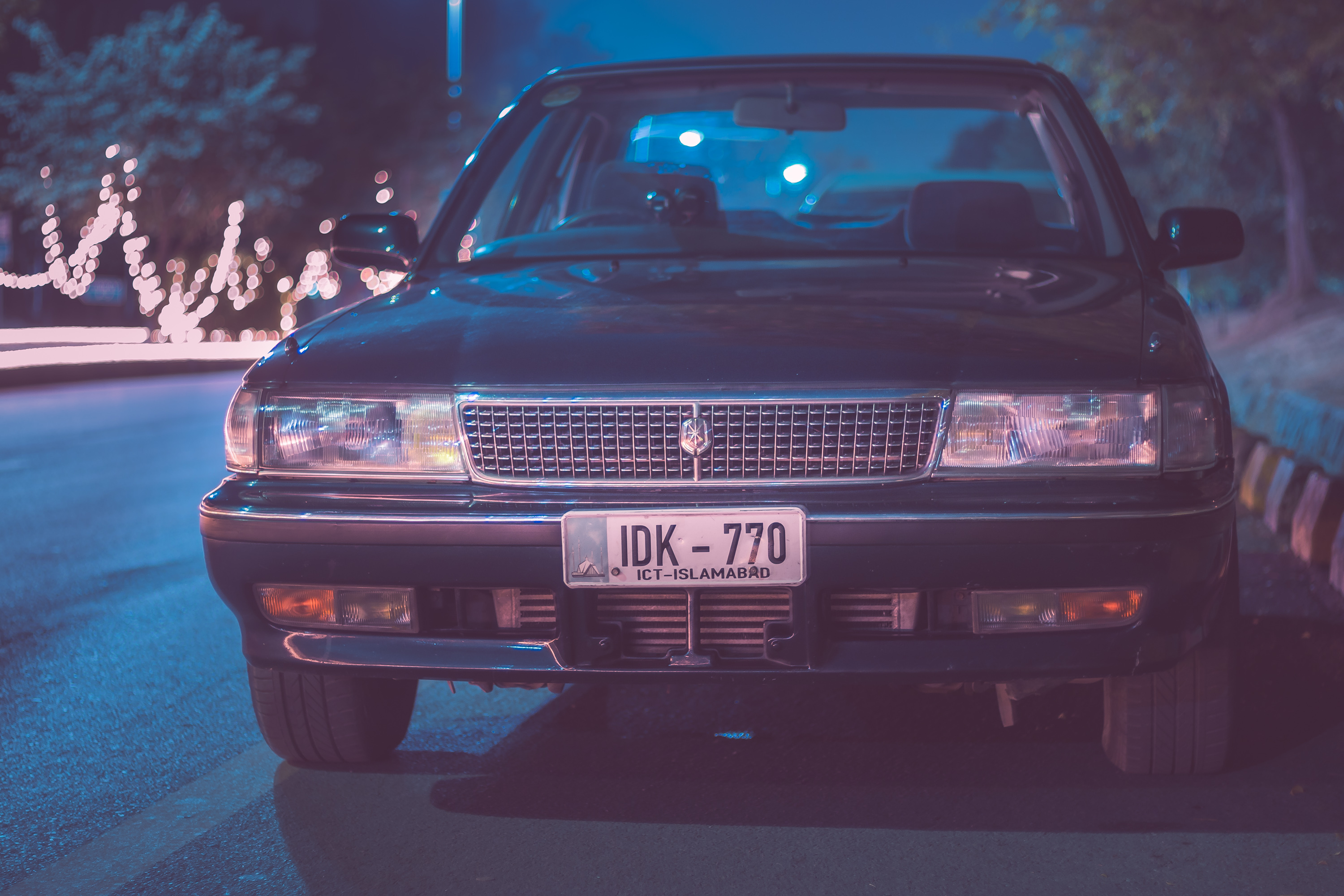

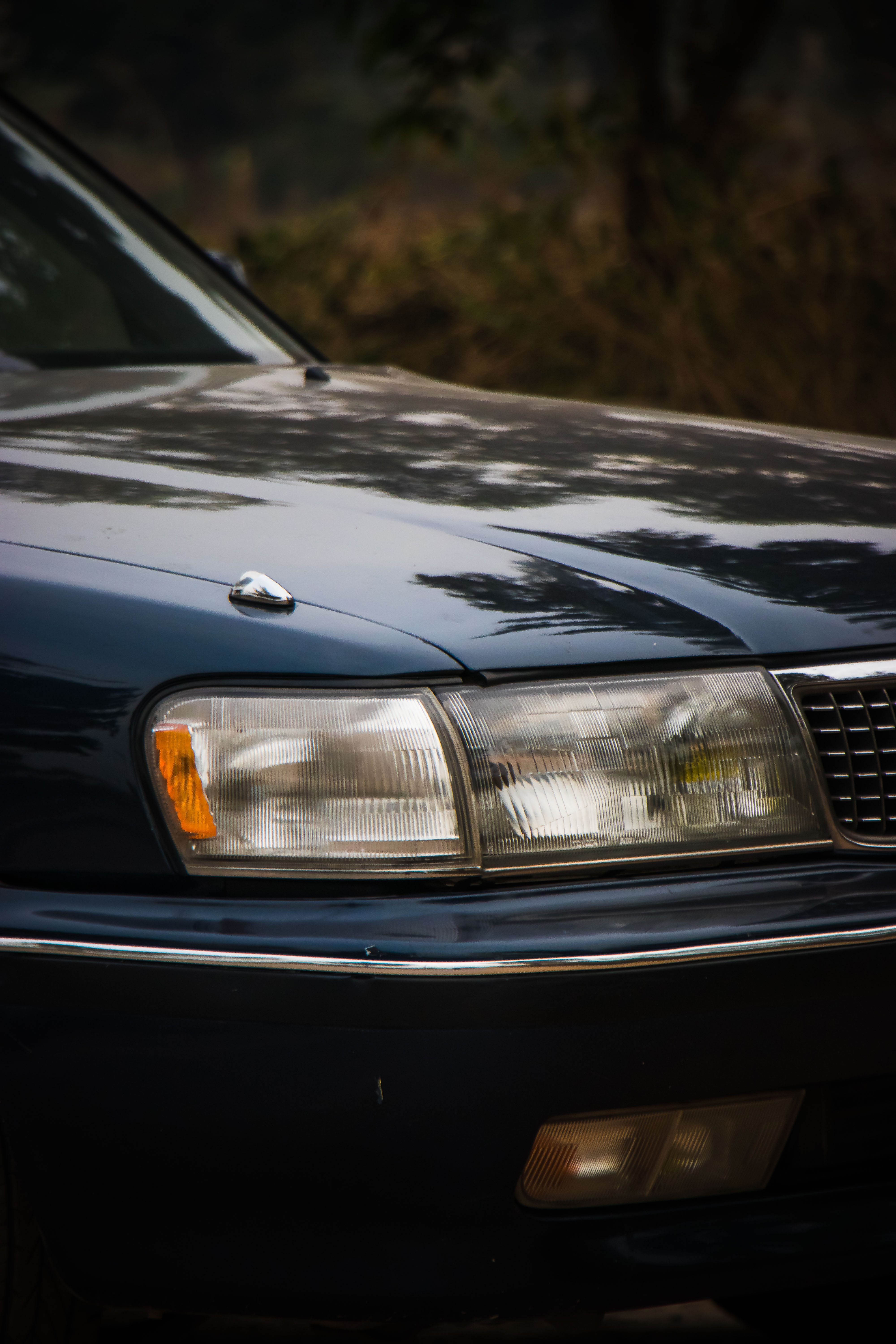

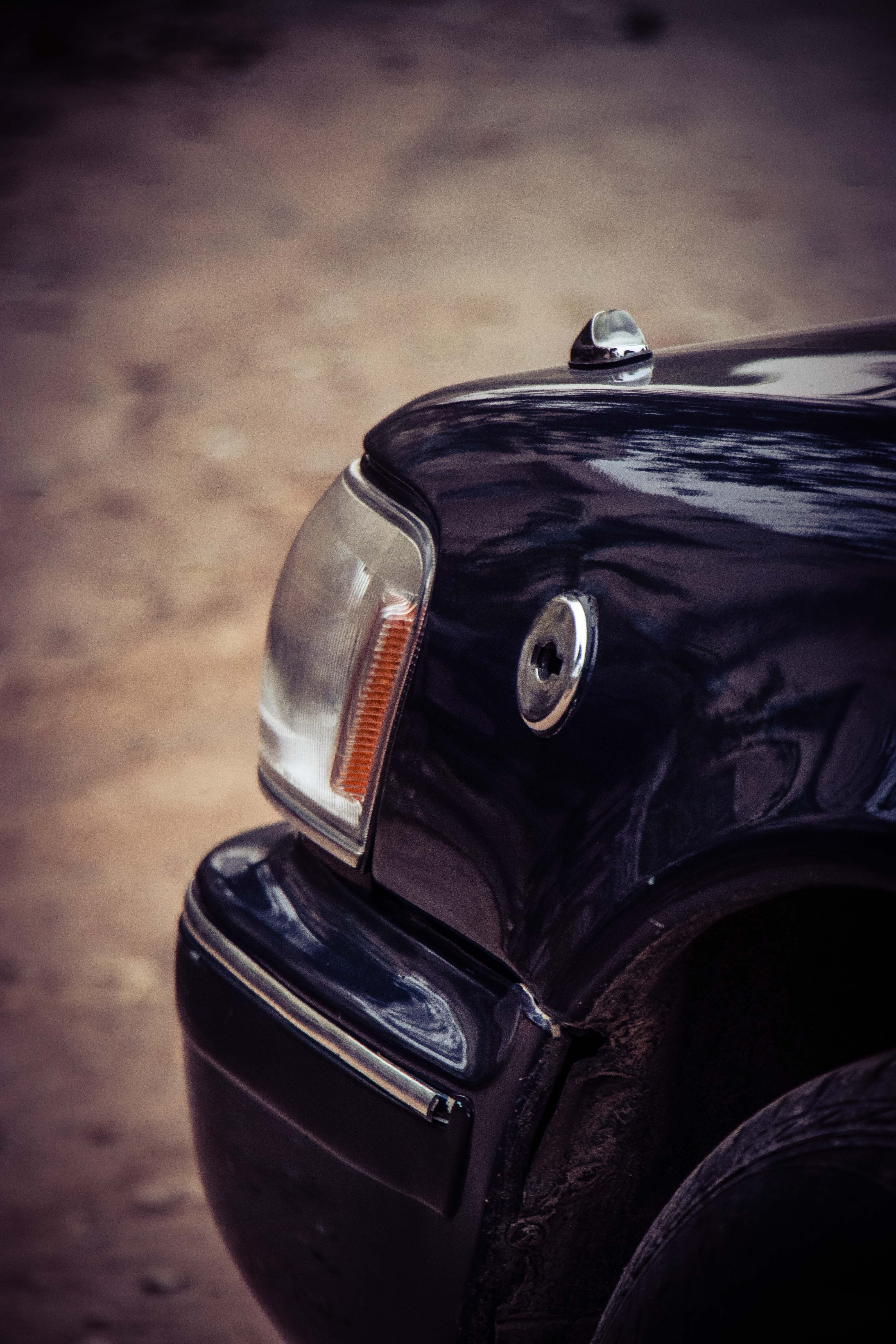

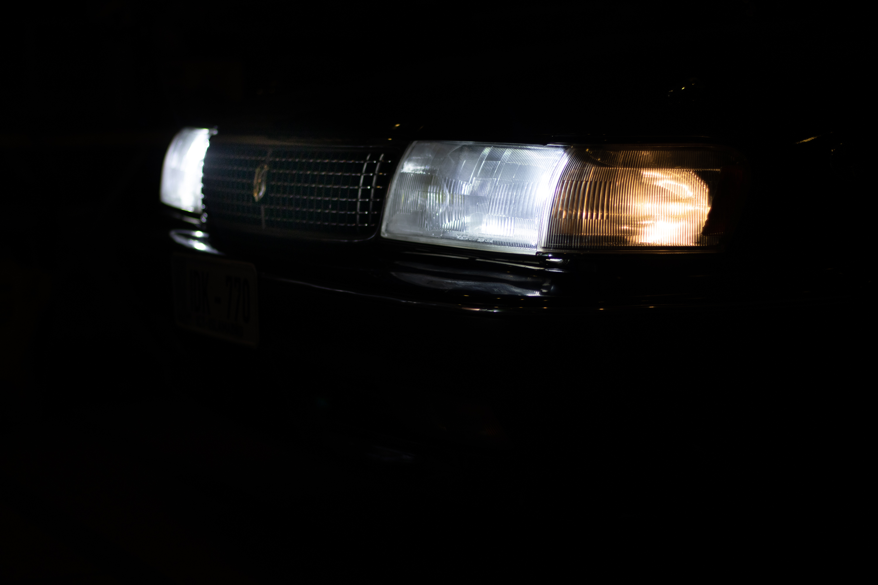

Also installed JDM fender lights

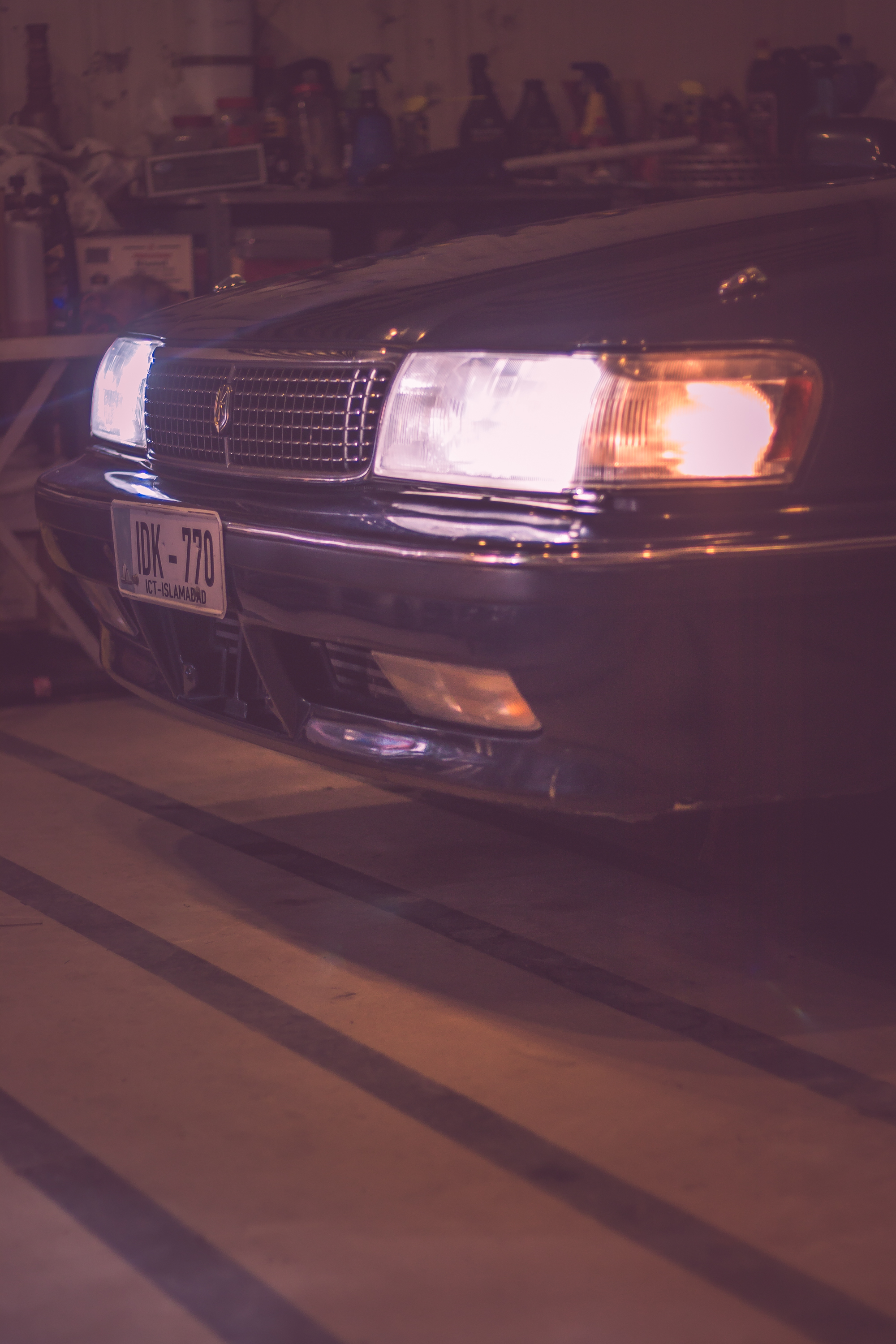

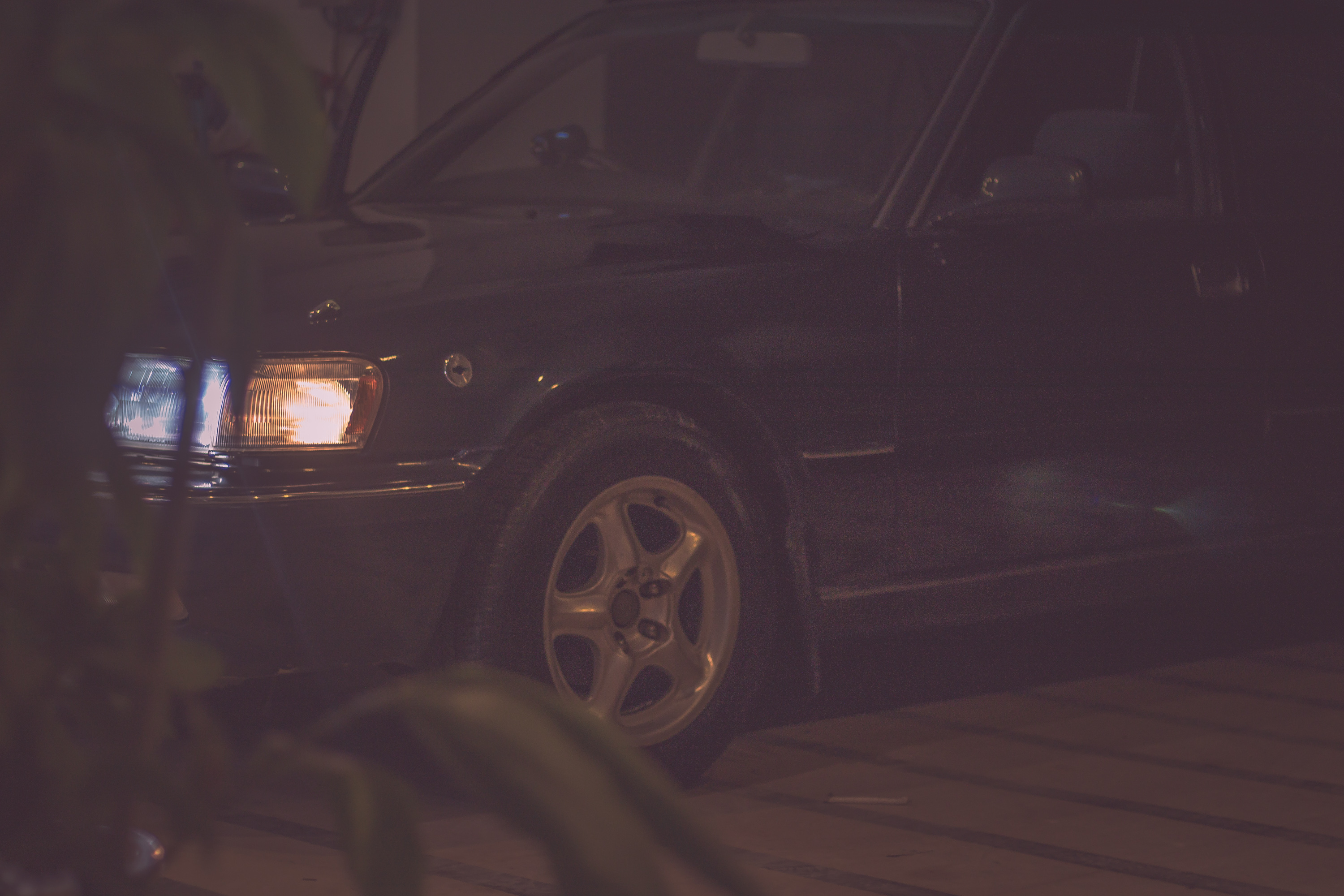

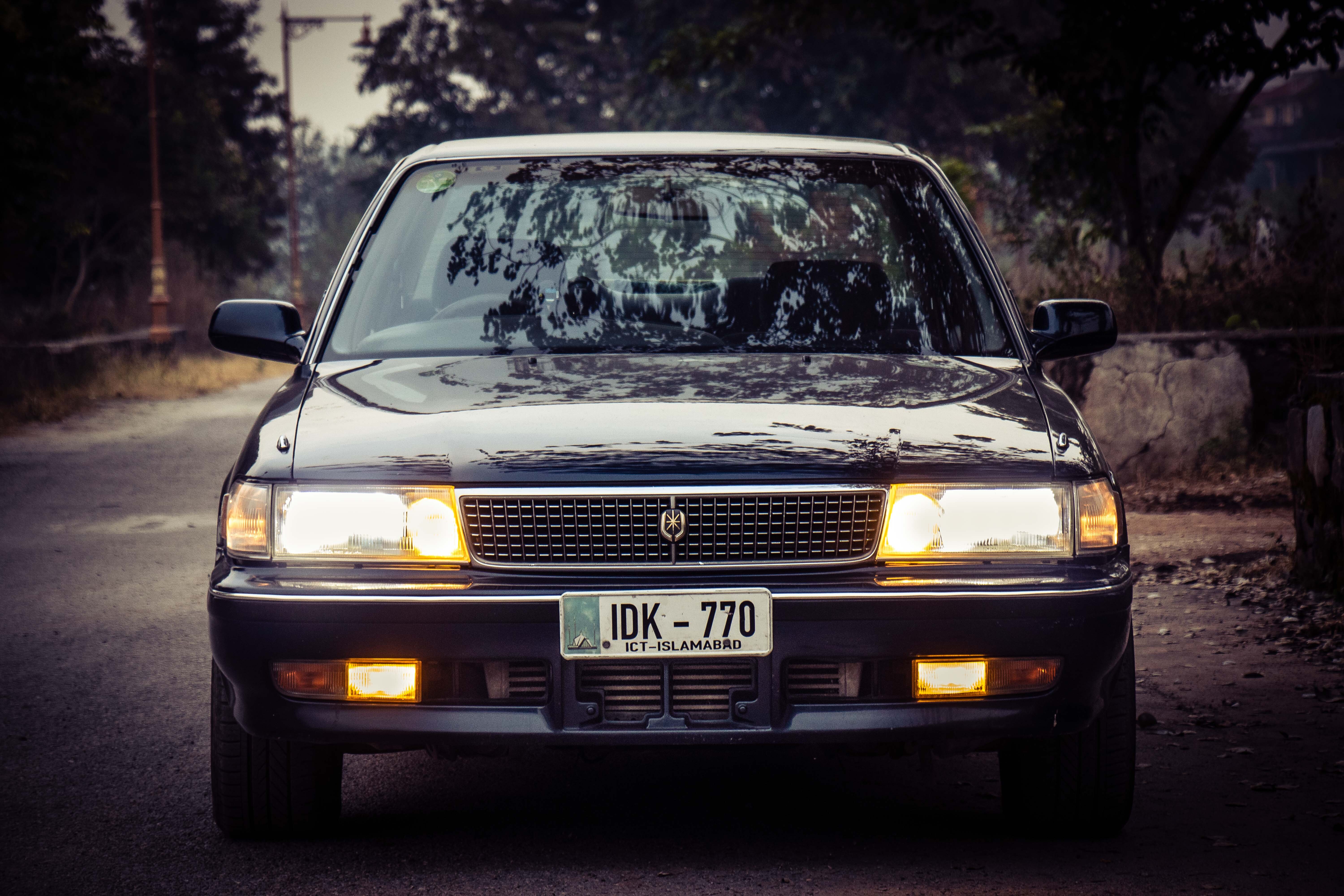

Along with this, Auto lights and cornering lights were also wired up. The Auto lights turn on whenever the sun goes down, and the cornering lights come up when the headlights are on and any side indicator is engaged. The video demostrates this:
