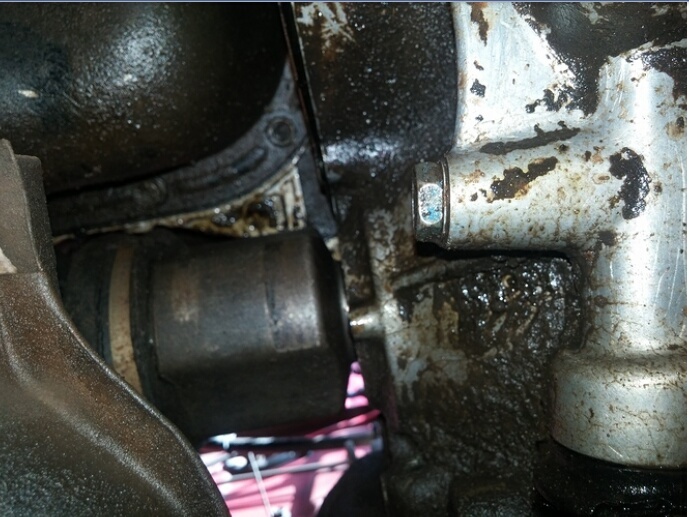

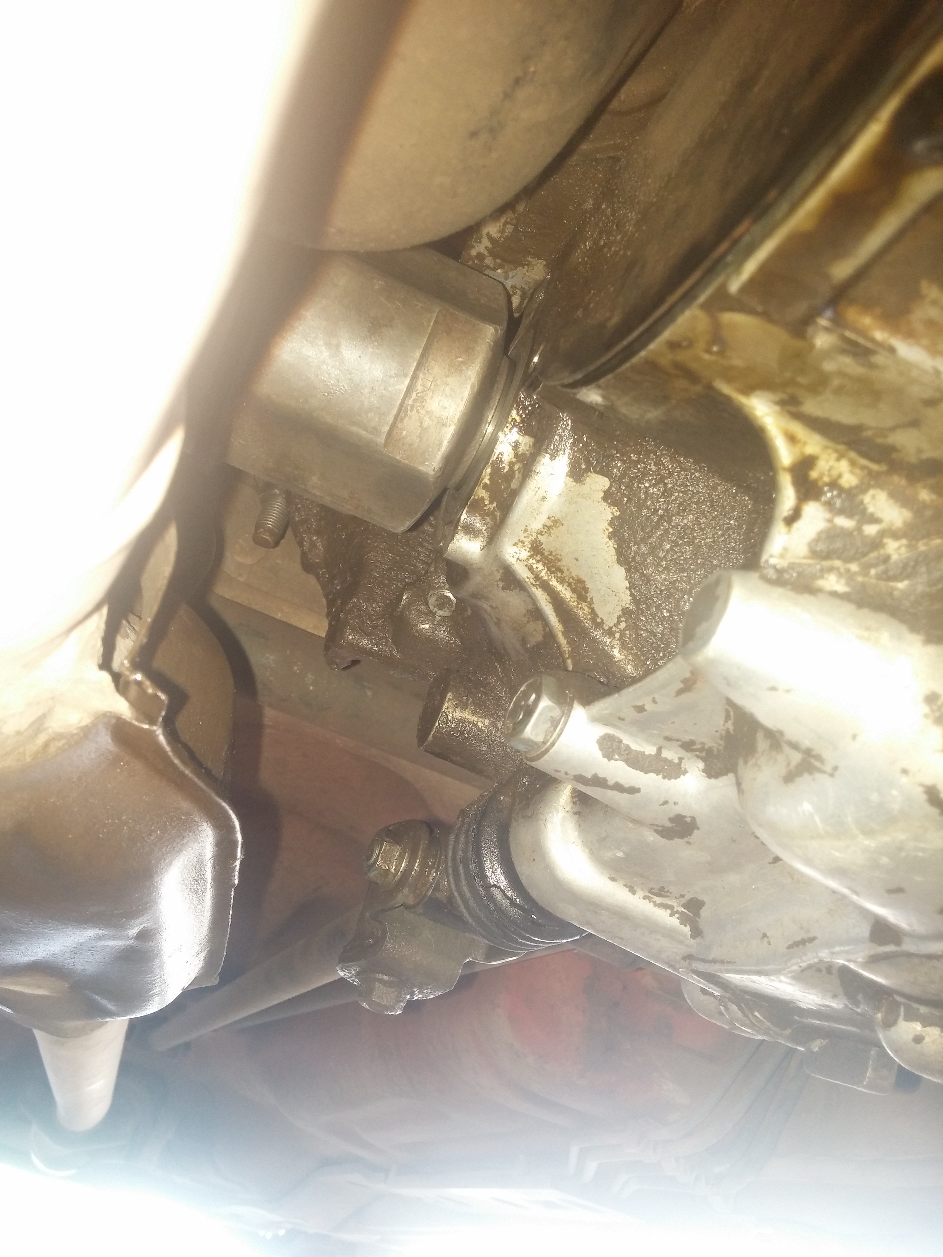

It is already in dont know why it is moving 1/4 inch back and forth
The

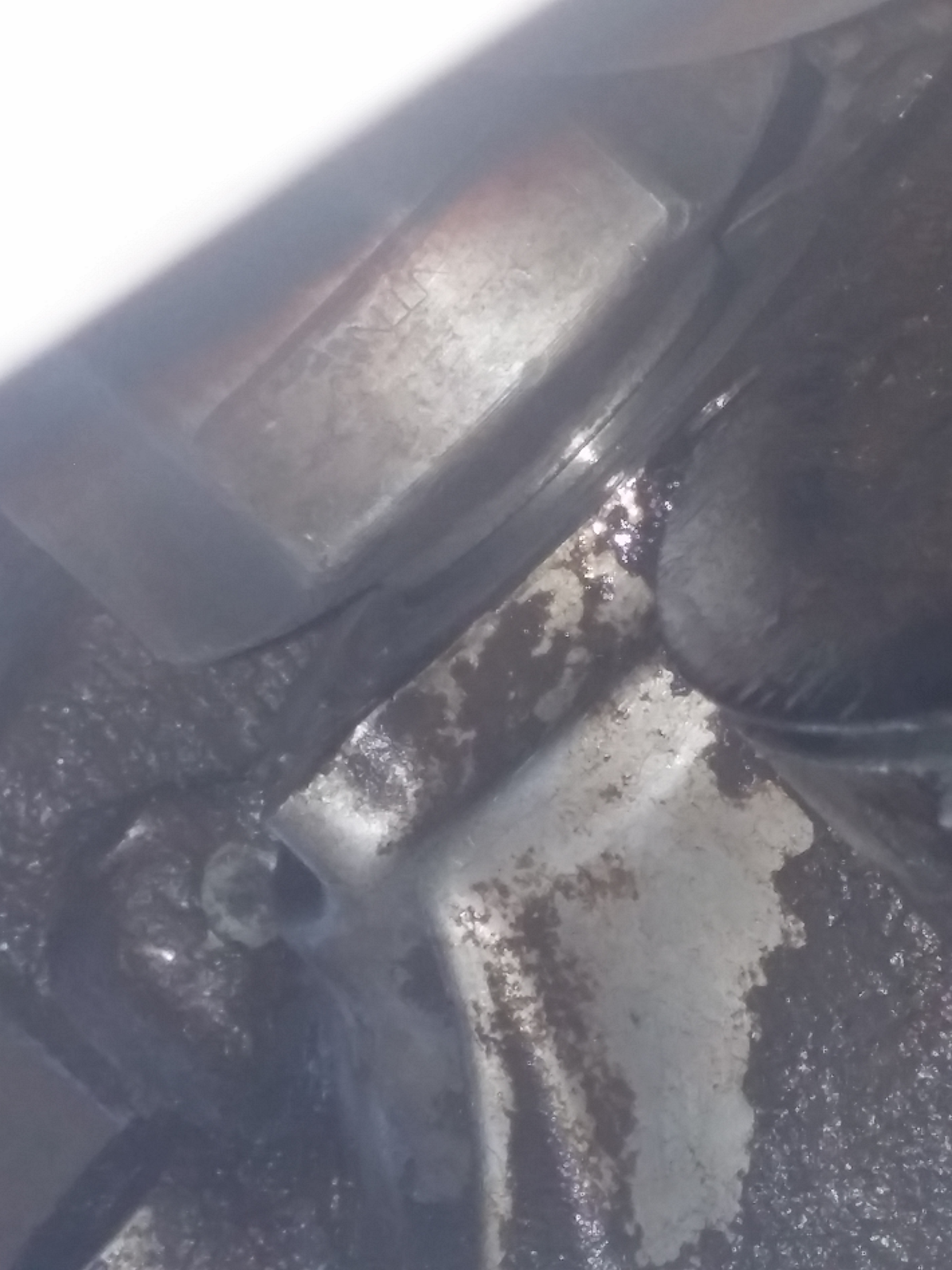

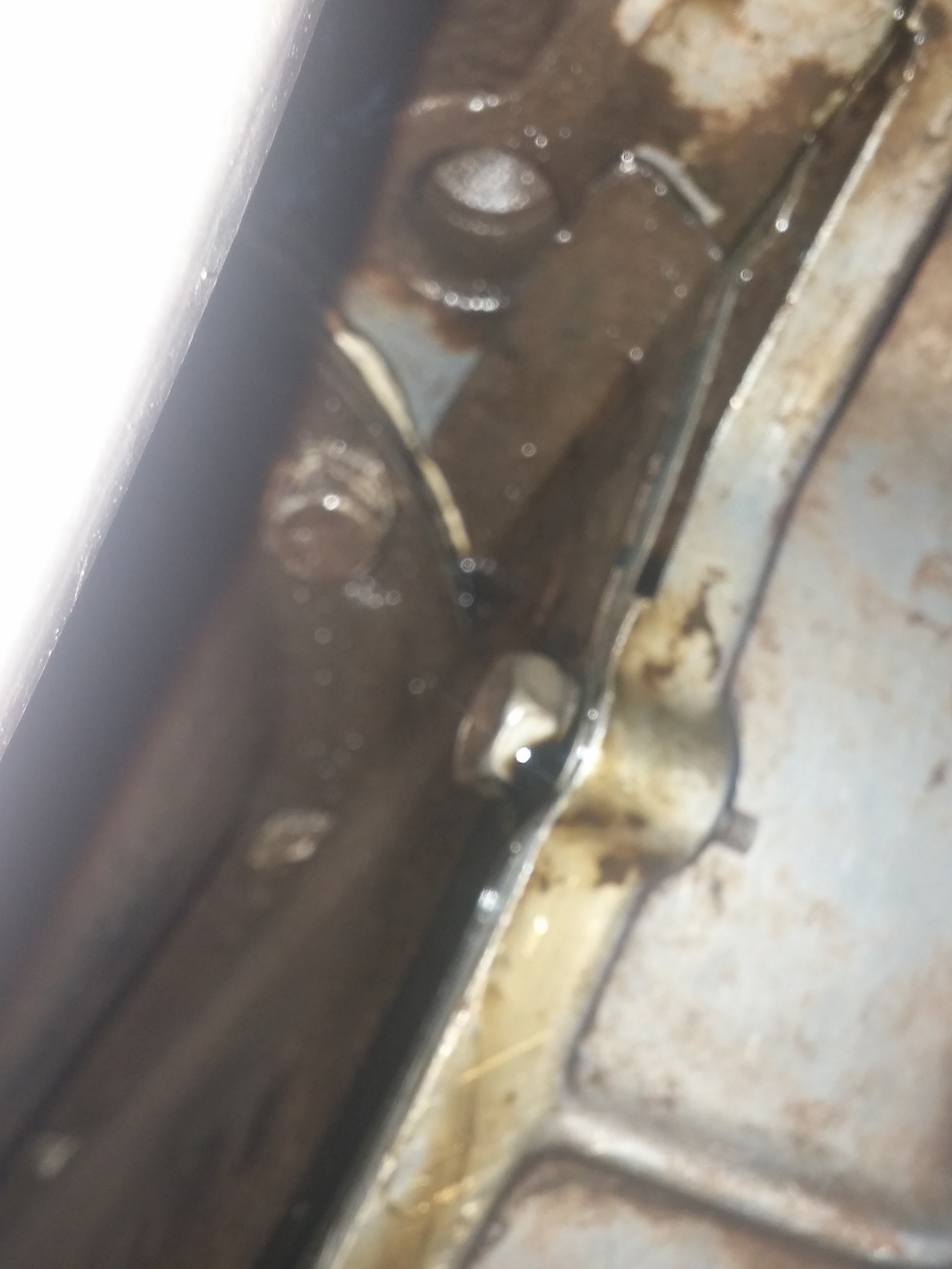

g the gap is due to missing not will it help the leak if put back in?
Bro this gear leak was also present before the t valve and after service it was not there for about 2 weeks then after checking the pcv started again om the next morning
The smell of leaking oil is like the oil used in remote control cars motor as i remember my little brother had one

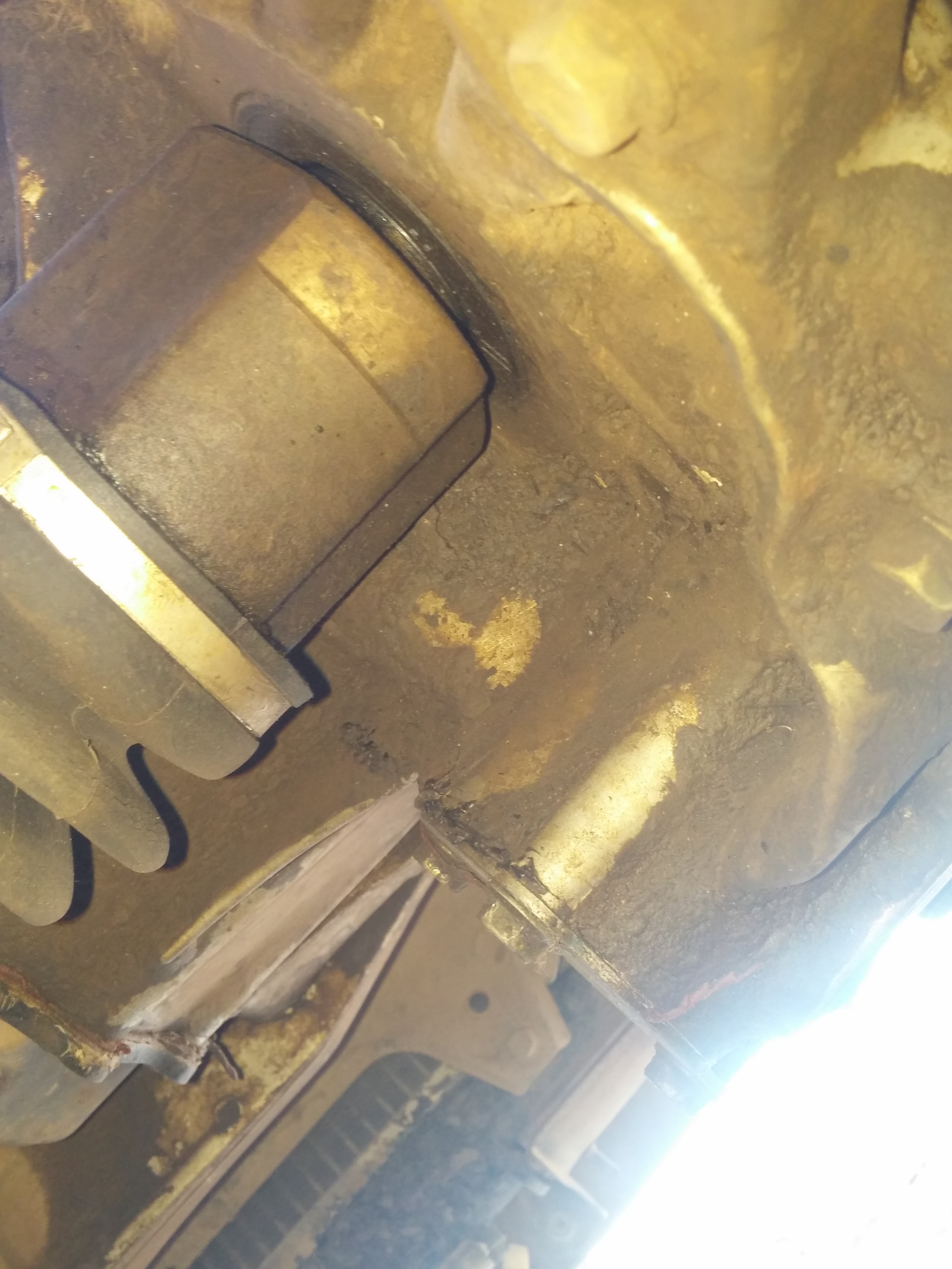

So it is confirmed that the gear oil leak is the culprit not the engine oil engine oil is not decreasing that fast only 19 20 ka farq hai last 2 weeks se
Beacuse Im changing the engine oil next week so thats why if the engine need to be opened( gear box) the oil might not be wasted
