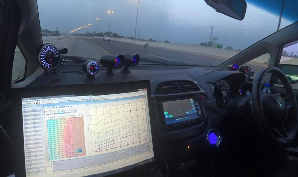

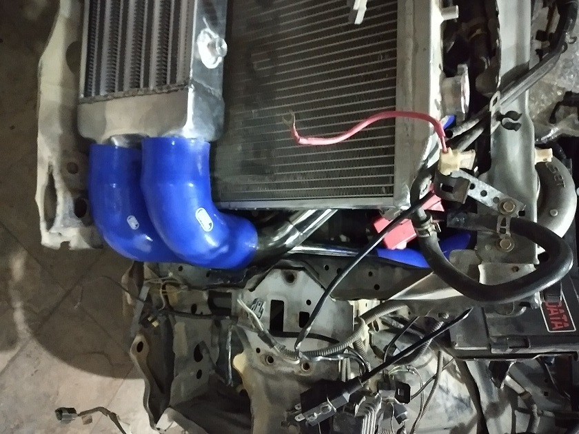

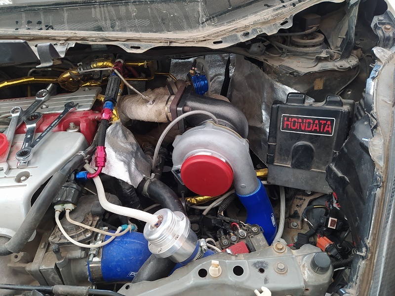

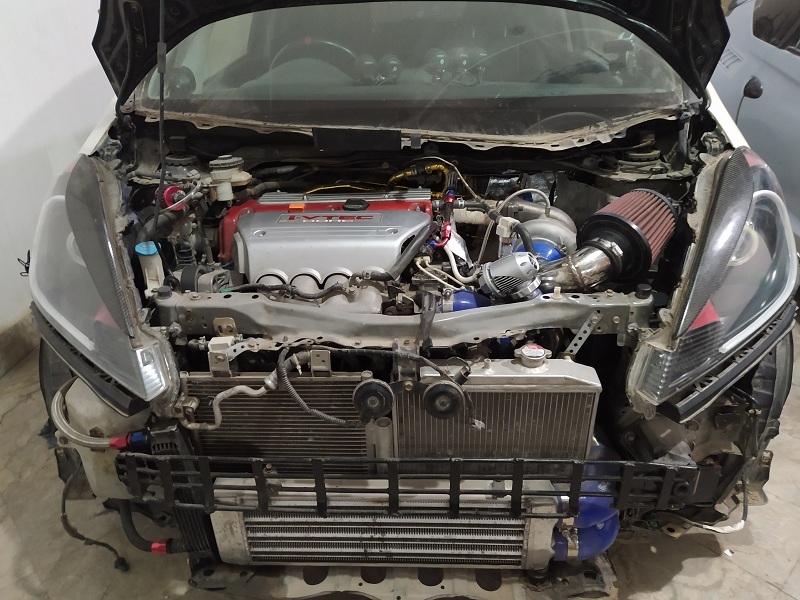

mine is on Hondata flashpro,Hasport mounts,Gt 3076 turbo. The torque is insane.starts at 2500 rpm and full at 4500 rpms. The car just moves. using An lines and fittings,self imported. Every thing done myself mostly. Whole exhaust is 304L stainless steel and the sound is eargasmic.

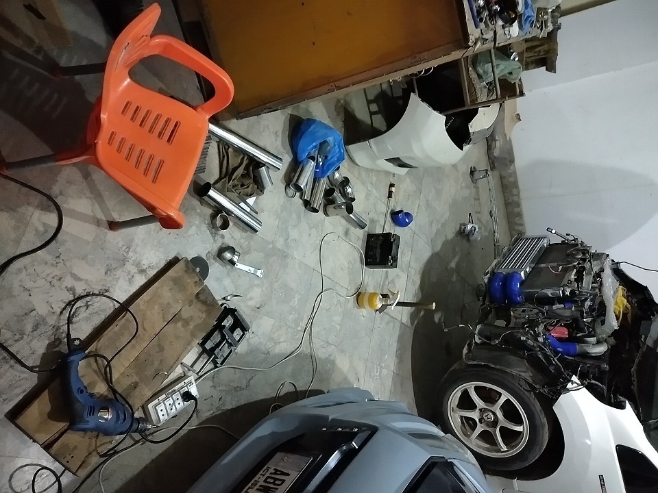

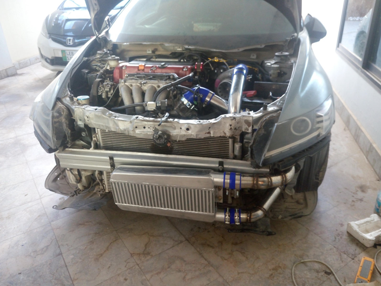

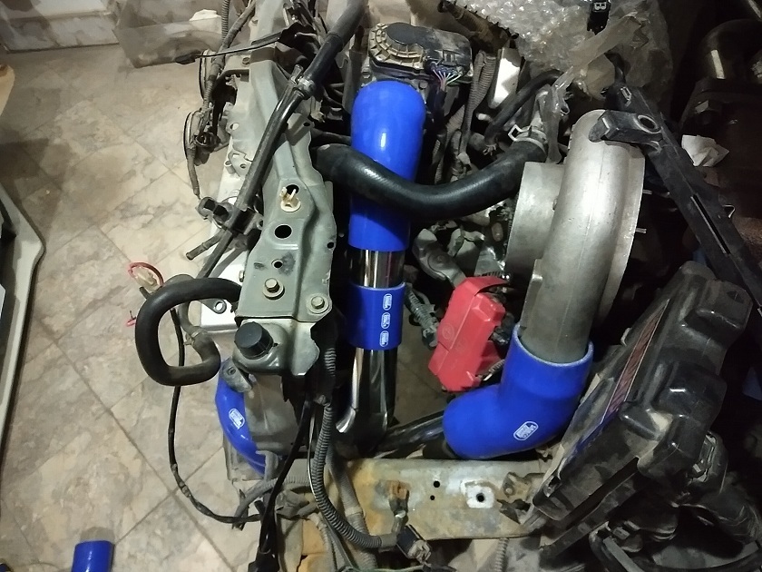

Lot had to be done to fit this setup in such a small engine bay.
My advice..........Go all in or dont do it. People who do half heartedly and without planning and low budget. Most important are a quality Turbo,fuel pump and injectors,FPR and tuning setup and proper tune(dyno or street both are ok but i see here in Pakistan tuners only tune WOT not the other part of map, eg partial throttle . That is where the car will spend it most time running. So if that is not done right to get alomst zero fuel trims and engine durabilty will be compromised) .Plus the guages are must especially with an alarm. They saved me multiple times.

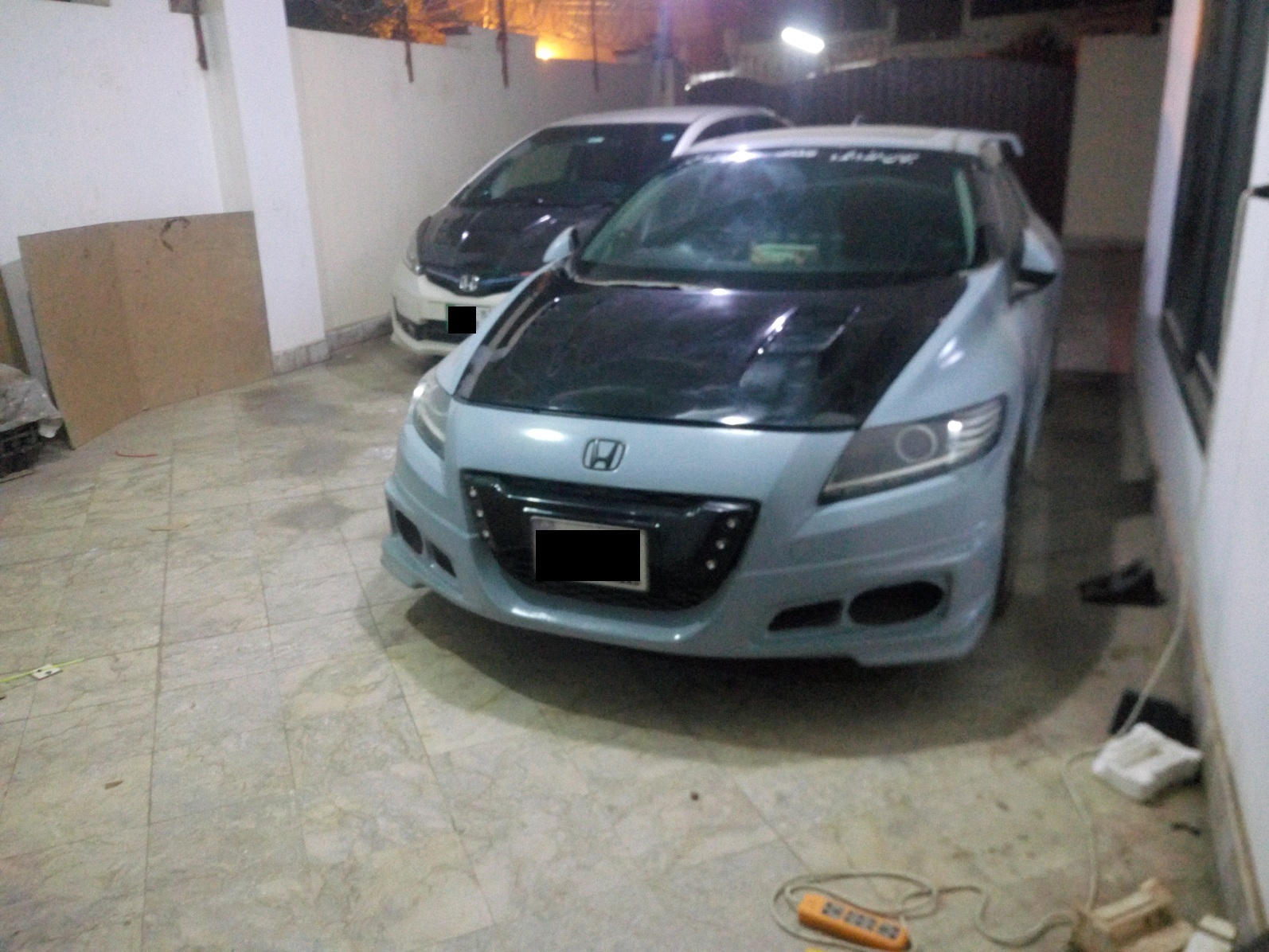

Here are some memories when it all began. You can see how small is engine bay
